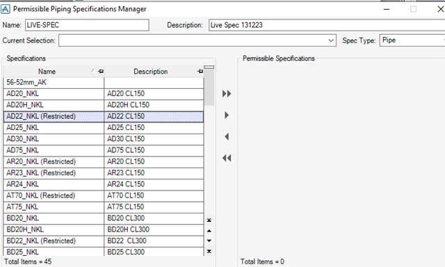

Is this permissible spec only can be setup by HUB?
Currently im working on NON-HUB paragon, but the permissible spec is grey out, (the arrow key)
(same goes to unrestricted spec,; refer picture)

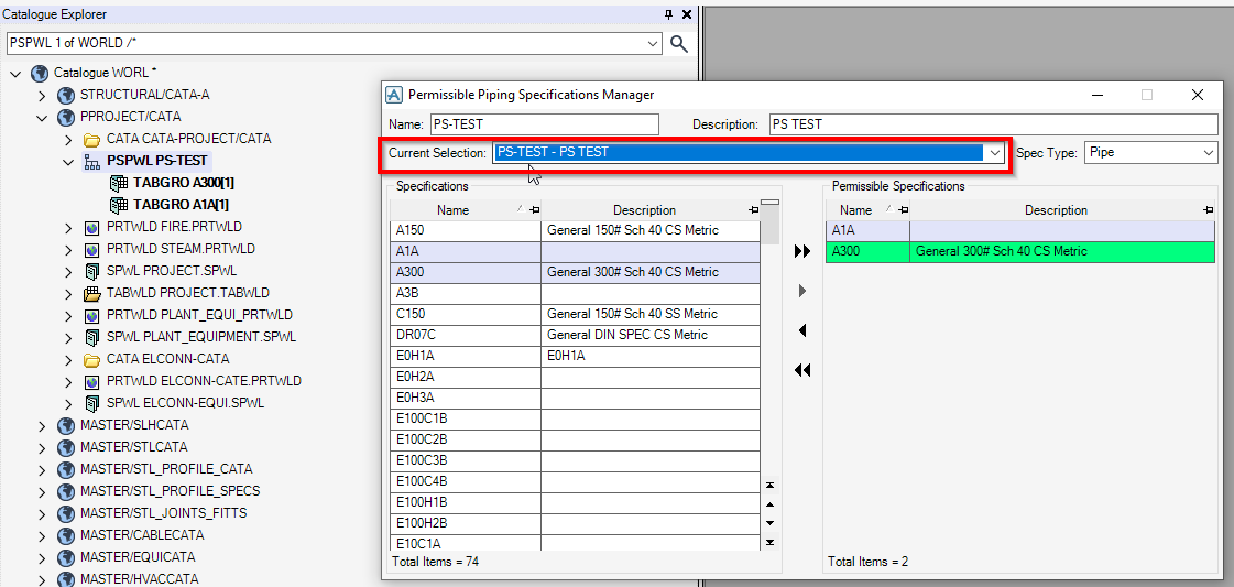

Make sure your PSPWL is selected in the form as shown below:

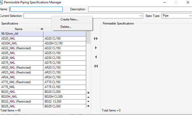

lol, need to right click to create new PSPWL, i see, im looking where to create the pspwl, i even try to " new pspwl" manually haha tqtq
*note to anyone reading this
Situation
HUB using SPEC eg AD20_AK
NON HUB using SPEC eg AD20_NKL
due HUB dont give read&write to their database, above situation happen
What it causes is,
If HUB does not have this PSPWL setup, and non HUB set this up, assuming DB CATA if inside in each other MDB,
HUB will not see their spec eg AD20_AK in their design.
