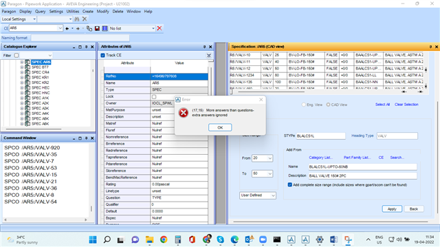

at the time of loading a spec i am getting this error , & not able to get the require spco's in spec
Can anyone just guide??

Difficult to say.....Could you please export ( CAD View-->Export Spec button) your spec on a file and upload it here?
thanks corrado for your promt reply , please find the attached export report... CR4-SPEC.txt
From a quick look......
You have some ATTA SHOP and BEND SHOP set to "OFF" instead of TRUE/FALS
Then for other components you have SHOP set to FALSE instead of FALS
Not sure if this is causing your error message...
