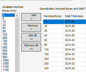

Hi Friends,
Why left image Available Nominal Bores not appear in Text list as per right image?
Please Help thanks..

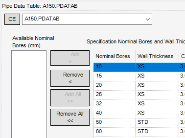

    Anyway, I think the reason is that all possible nominal bores are already loaded to your Pipe Data Table in the left image, which makes the Available Normal Bores list empty.
    If you try to click the Remove button, you will see that bore will move back to the Available Normal Bores list.
