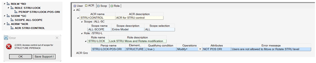

Hi,
Thank you for sharing. I tried to create all the scope, role and ACR but when I test in Design I got the error message
Do you know what could be wrong here?

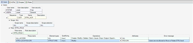

as per manual, once DAC is ON, all are restricted. meaning we must add PEROP to ALLOWED modify all first before restriction. Sorry, I made a mistake on the attributes. Operation shall be Modify Disallow and Attributes will be POS ORI
I assume you also apply the ACR to the user.

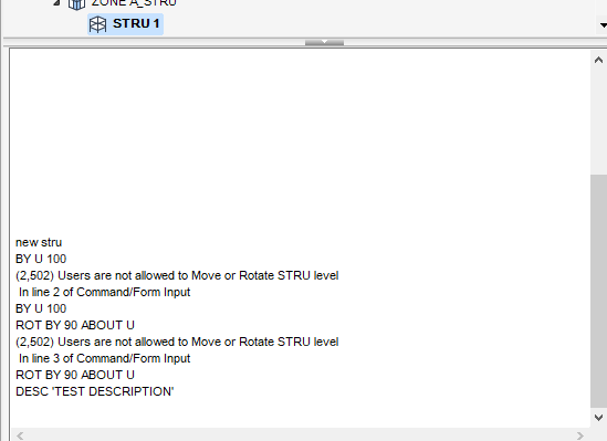

I tested this PEROP and it Can Create/Delete Stru and modify properties aside from POS and ORI
Thank you! I didn't create a PEROP to allow all, and also forgot to set ACR reference to the user. Now it works
