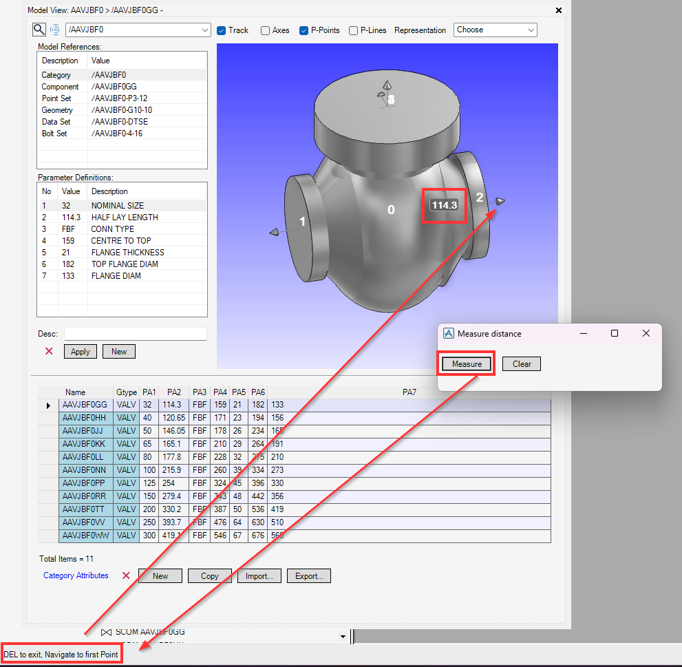

Hi,
Any one knows if it is possible to have measurement tools available in Paragon, it would be really useful for checking purpose.
/Anh

    You can try with this.
    It was shared on this Forum a while ago.
    Change extension from .txt to .pmlfrm
  • Thanks Corrado, but the form is not working. And that is not what I need as well, I want something that we can snap and measure as what we do in Design module.
  • Ok. I apologize.
    Anyway the form does work ok.
    It returns the distance of a P-Point from the origin.
  • Thank you!
    I didn't test it on Piping component, but it didn't work on Structural component (ie. Gensec profile).
  • yes, p point to p point distance we can get
