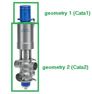

Hello Experts,
Would it be feasible to include both geometries in a single catalog?
e.g. there is one CATA is mix-proof valve and one CATA is motor.
thanks in advance.
Hello Experts,
thanks in advance.
one geometry, one point allowed GMSE and PTSE, it seems it is an instrument valve. Your job will be easy if it is a single geometry and point set. Customers will not question you if it is a single component. Multi geometry sets and multi point sets can be created in a single cate but scom will take one geometry and one point set.
Thanks #venkata for reply,
Yes you're right if I will use one cata with multiple points,
But this case I have 3d model in STP for a valve top motor, so can I use that 3d shape As extrusion primitive in paragon ?
use geometry based on your convenience.
