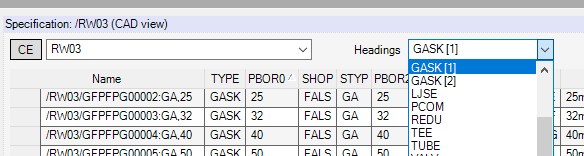

On my pipe spec, I have two types of Gaskets. One on with Heading [GASK1] and the other with Heading [GASK2].
When I insert a flanged component with Auto Create ON E3D is giving priority to the [GASK1], but I want [GASK2].
Is there a way to modify Component Priority on the specification without delete ?

    you have two gasket headings probably because the selectors order or number is different.
    What I would do is exporting the spec (only gaskets) with SPECONMODE, "old" option,  on a text file.
    Edit the file so that you have one heading only and the correct sorting.
    Run back the file.
    For example, the syntax could be as follows:
    SPECONMODE
    FILE /C:\TEMP\GASKET:MAC
    COMPACT
    OUT OLD GASK /RW03
    TERM
