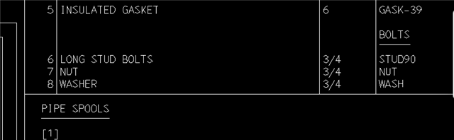

Dear Experts,
The bolt length is good when Column 2 DESCRIPTION with Width 41 but not working when Column 2 OTHER Heading 'COMPONENT DESCRIPTION' DTXR FROMSPCOM with Width 41
how to resolve

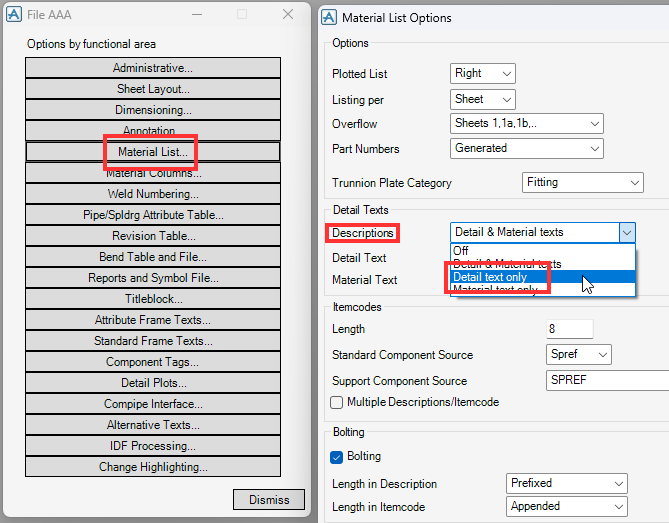

Instead of using OTHER and DXTR FROMSCOMP, use DESCRIPTION and:
That should correspond to:
As far as I know, bolt lengths are included only in DESCRIPTION and not in OTHER

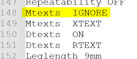

Is it possible to write like this,
Dtexts :TESTDESC
