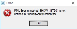

MDS User Defined Support ERROR
Anthony Castillo
Anthony Castillo over 6 years ago
  • Anthony Castillo
  • Anthony Castillo
    Does this mean AVEVA supplied User Defined Supports which can readily be activated in paragon but cannot readily be used in design??

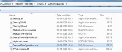

    I manually add the tags in the [LEFT][COLOR=#333333]SupportConfiguration.xml file, and it worked.. I guess I need to do this again and again for the other user defined supports..[/COLOR][/LEFT]

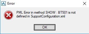

    I have the same problem . [COLOR=#333333]I manually add the tags in the [/COLOR][COLOR=#417394]SupportConfiguration[/COLOR][COLOR=#333333][FONT=Verdana].xml file BUT not worked.
    any other thing I should do?
    [/FONT][/COLOR]
  • Venkata Rao Peta
    Venkata Rao Peta over 6 years ago
    add through DimensionControlDesigner.exe from installation folder.
  • delaram
    delaram over 6 years ago
    It works . tnq for your help.
