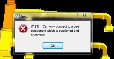

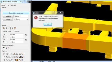

Hvac mds modelling error

    Does it happen when supporting circular shapes?
    Which version are you on?
    Q BANN on the Command Window...

  • sanjyot
    sanjyot over 6 years ago
    This error will appear when Ancilliary is not placed at proper position. Please check placement & orientation of the ancilliary.

  • Jermaine Nuevo
    Jermaine Nuevo over 6 years ago
    Hi guys problem is solved. This error occurs when the HVAC are not properly modelled, hence supports cannot be placed properly as well.
