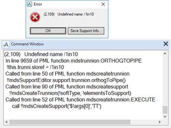

Trunnion Creation On 3D Model

Fares BORNI

P.Basker
over 5 years ago
Yes. E3D 2.1 Supports.
Copy this /STANDARD-PIPE-SLOPES from DB 7000 to your Catalogue DB.
Fares BORNI
over 4 years ago
[QUOTE=P.BASKER;115958]Yes. E3D 2.1 Supports.
I have already this DB in my catalogue and I still have the same issue.
Regards
P.Basker
over 4 years ago
check the Cata DB is included in your MDB.
otherwise Type in command window " /1in10 ", while you are in Model (Design).
