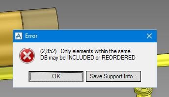

  • mEhul_patel
    mEhul_patel over 4 years ago
  • Venkata Rao Peta
    Venkata Rao Peta over 4 years ago
    include db work with same database.
  • NAGENDRA VUDDAGIRI
    NAGENDRA VUDDAGIRI over 4 years ago
    use below command for moving to different database
    INCLUDE ACROSSDB /Name_Of_Object
  • Venkata Rao Peta
    don't try this, instead of this this copy with macro.
    any specific reason to avoid across command other than time it would take to execute?
