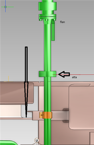

    Dear all
    in a specific context ,suport is duplicated on isometrics drawing and material list isometric.
    Context that i find is :if compref is a tee and an ATTA is present between ancil and tee ,the bug is comming
    Why this context ,because:
    test 1 : i delete atta --> it's ok
    test 2 : i keep atta but add a weld conn ti tee (compref become weld) --> it's ok
    each case that user report me are similare but:
    i can't replicate myself, could be an other conditions that  i don't know ,try on project and also aps project.
    Do you have already see this bug?

    i face same problem.
    e3d 3.1.7
  • Arif Kazaro
    Arif Kazaro 8 months ago in reply to Arif Kazaro
    what i did was compref to previous component (in this case flange) but if using allign support button it cannot be done (illegal reference), i force compref flange 1 ..... or ref
