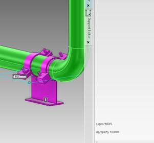

Is there any way to change shoe height in Design as per insulation Thickness.
1) I have defined a Expression in Shoe Category with ATTRIB IPARAM[2]. 2) In Ancillary Data form . I have defined Alternate Expression.
3) In design i can query RPRO WDIS but it is not changing support Height.
Kindly review, If there any Mistake in my procedure or If there is any alternative method of doing this.
Regards
Vineet Bhardwaj
Hi vineet you should create new DTSE in your CATALOGUE and try this.
