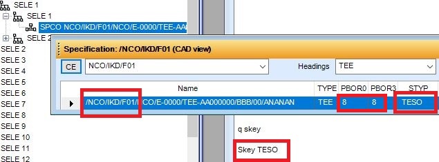

Pipe Support(MDS)
SET ON TEE not found in current spec

your pbore definition is wrong
p0bore or p1bore, p2bore
is maindiam (runpipe)
only p3bore define branchdiameter

Thanks joge!
