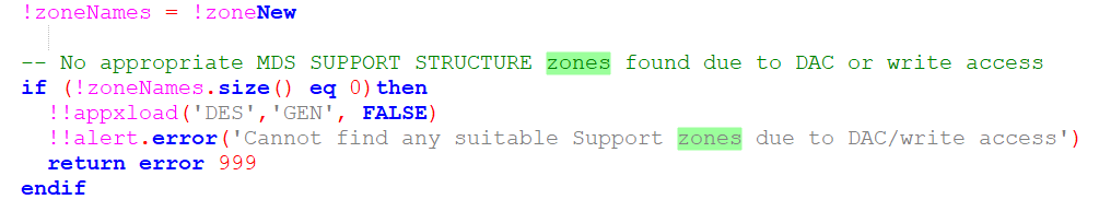

After creating a new Zone and setting its PURP to SUPP I get the follow error:
'Cannot find any suitable Support zones due to DAC/write access'  when i try to enter the Support Module.
It then kicks me back to my previous module.
I certainly do have access as I just made the Zone in the same session. i can also manually create a SUPPO in the Zone.
Background info:
I'm running E3D 2.1.0.26
Project was recently upgraded from 11.6
All my other 2.1 projects open Supports OK.
DAC is turned off.
I believe all MDS DB's are present.
I have tried entering using the system user, same error.
I have entered var !supportzonename name
many thanks!
