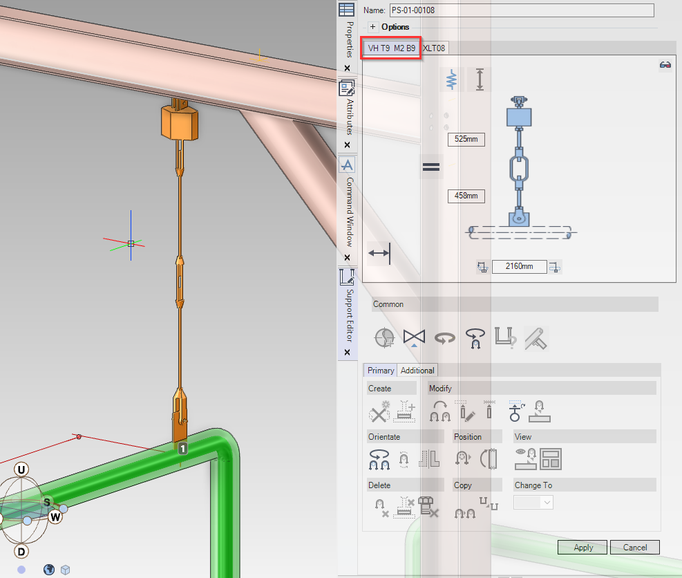

I need to place hangers on insulated pipes(without pclamp). For example, a Aveva VH with B9 (Hpin+ Clev+Hnut..).
I have tried on my installation E3D3.1.6 and it works.
What kind of problem do you have?
I am working with E3D 2.1.0.25.
When I am going to place a hanger(Single to Beam) on a insulated pipe, Template Hanger Creation form appears with the list of variable hangers that have PClamp
