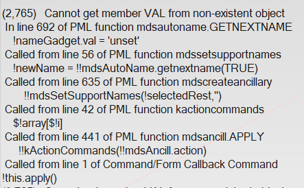

But was unsuccessful with error as below,

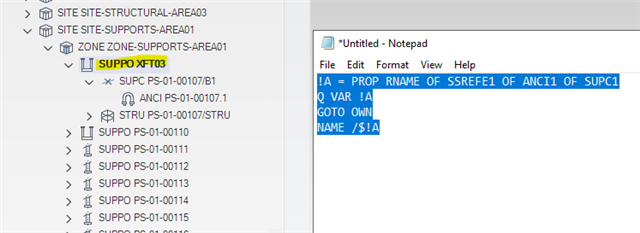

If i query the same in DESIGN the value is displayed with the result like below,
Anybody has ideas please on how to name the SUPPO with data from the SSREFE?
