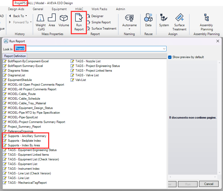

3 examples are available with APS Aveva supplied project:
You can find them in ....\AvevaPlantSample\apsdflts\Data\Reports
