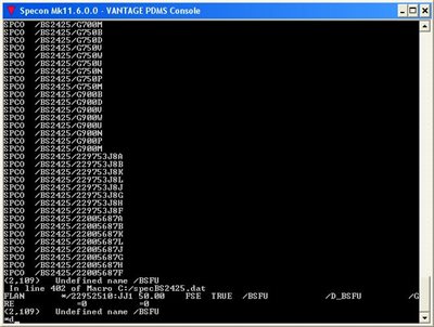

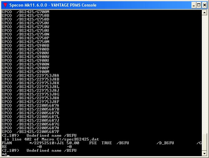

    The error is not about /D_BSFU
    SPECON is looking for an SCOM in the catalogue with the name /BSFU
    You need to create this SCOM in order to continue

    You need access to Paragon and training in CATS & SPECS.
    Speak to your company cats & specs guy. He will be able to add it for you.

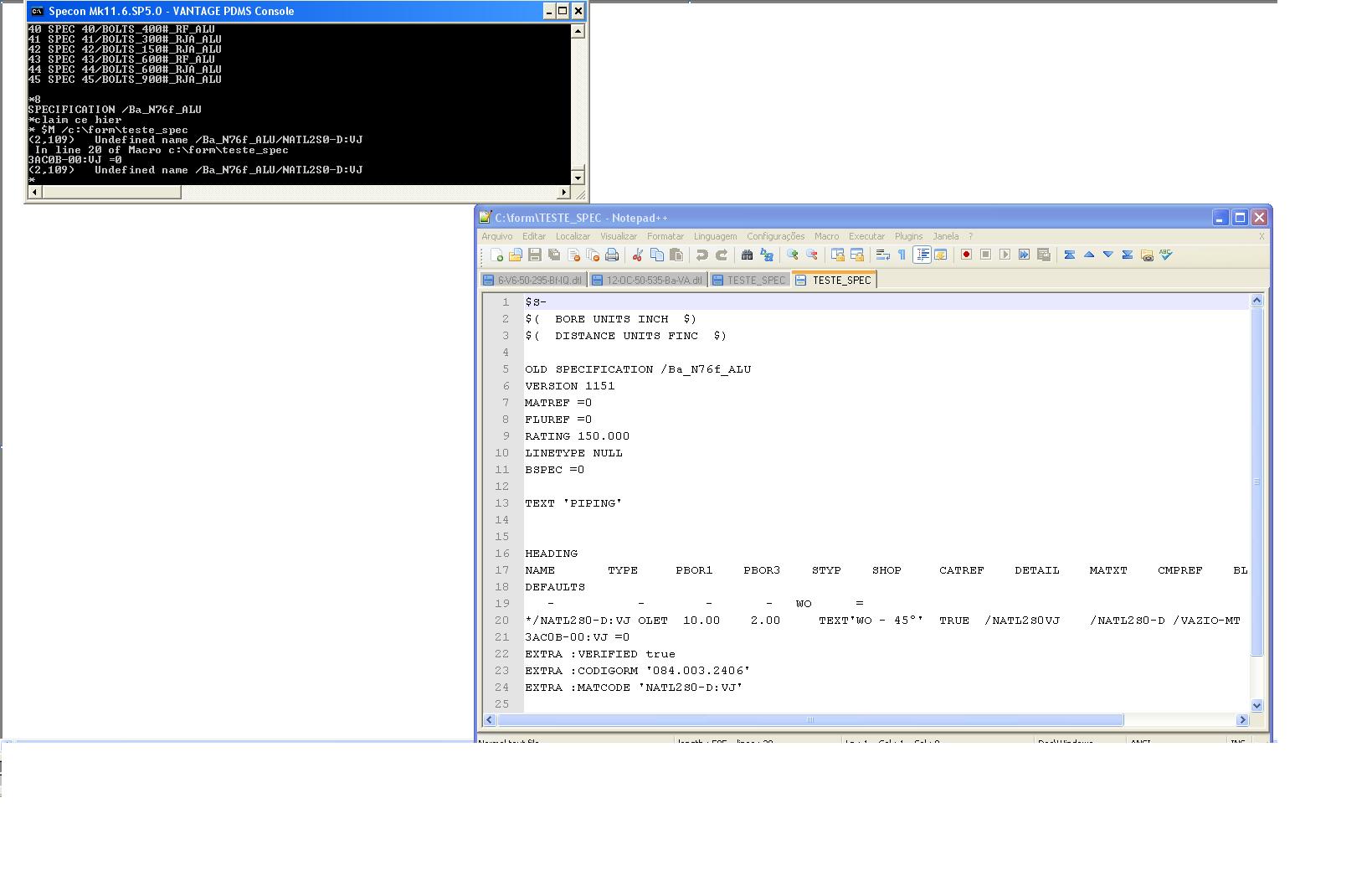

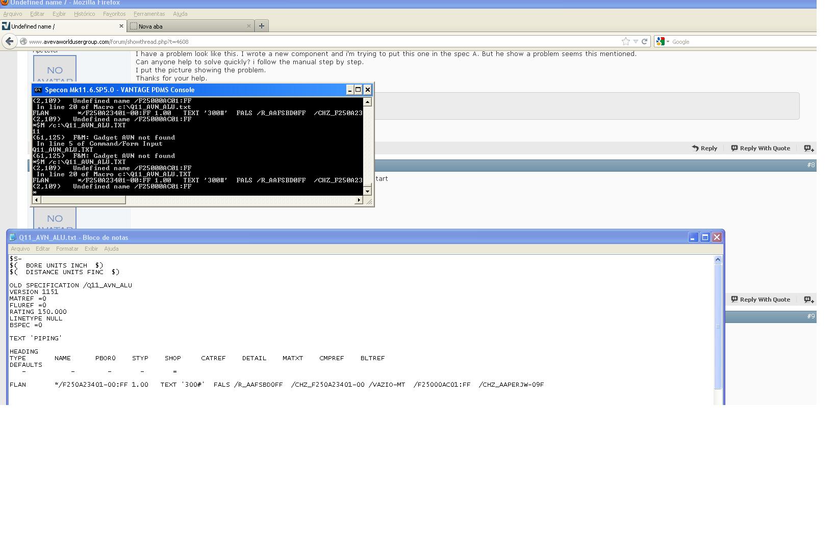

    When inputting a new component to your spec the HEADER needs to start
    TYPE  NAME ......................................
    OLET */NATL2.......................................
  • Swapnil Kulkarni
    Swapnil Kulkarni over 12 years ago
    Yes right pitch... When adding any component to old specification the first question in spec file must be type.... Else the component creation will be aborted...
