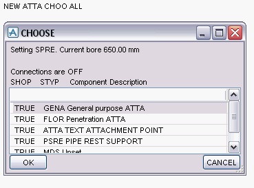

Usually Spec's are classified depends on SCH,RATING,so why you want to see in choo window,
Let me brief about it:-
We have default spec in sample project i.e A3A
here we know A=150#
here we know A3A meaning,right? still why you want to same details in choo window,if that option is there in choo window,you may loose control of all your specs,you will get 2 to 3 pages of STYPEs in choo window,so choosing will be dificulty so whaterver established procedure is there now,that is segregating depends on your spec by asking serveral questions.still if you want to see at choo window,create your own UDA to SPCO,and using PML Create your own form there.
