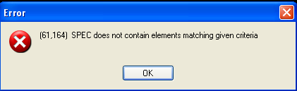

Specon Module
Error_Spec does not contain elements matching given criteria

This happens when your spec does not contain any element that fits with the bore size that you´re currently working.

Or the TYPE is not available, e. g. no VALV is in or whatever
