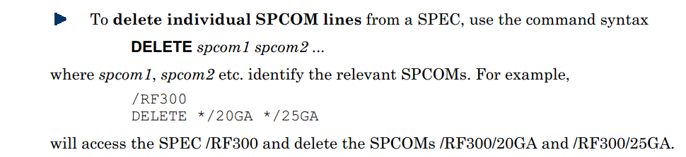

  • Duc Hung Nguyen
    Duc Hung Nguyen over 13 years ago
  • Rolf Suessbrich
    Rolf Suessbrich over 13 years ago

  • Parag S Newe
    Parag S Newe over 13 years ago
    [QUOTE=duchungktd;65235]Thank everyone for your reply!
    I do like your guide, but I still can not delete SPCO in Specon module.
    I am reading specon manual!
    And I do not know why It did not work like the manual said:
    have you tried a way which Prashant suggest?
    Tyr that. if It is also fail then...
    as per PDMSELDER said.. ask Support from Aveva.
  • Duc Hung Nguyen
    Thank paragnewe!
    I have tried it already!
    But I still can not delete the SPCO!
