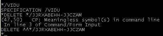

    The error says that is doesn't understand the gap between delete and *
    Corrado Galluzzi over 13 years ago
    Try with:
    OLD SPEC /VIDU first, and then the DELETE line........
    It should work. But nevermind....
    Try navigating to your SPCO first with /DIVU/JJRXABEHH-JJCZAM
    and then DELETE SPCO

    Thank corrado!
    However I still can not delete */JJRXABEHH-JJCZAM

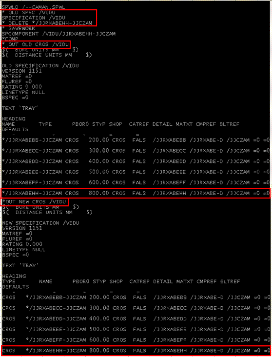

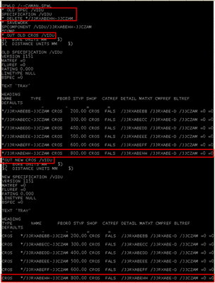

  • john pitchers
    john pitchers over 13 years ago

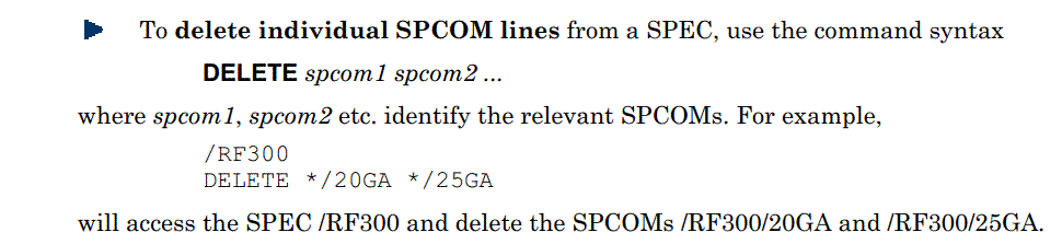

    The * represents the specname when inputting a spec in macro tabulated format.
    For Remove and Delete commands you need to replace the * with the specname
    eg
    REMOVE specname/JJRXABEHH-JJCZAM
    DELETE specname/JJRXABEHH-JJCZAM
    As I tried to explain,
    You do not delete */JJRXABEHH-JJCZAM
    You delete /VIDI/JJRXABEHH-JJCZAM
