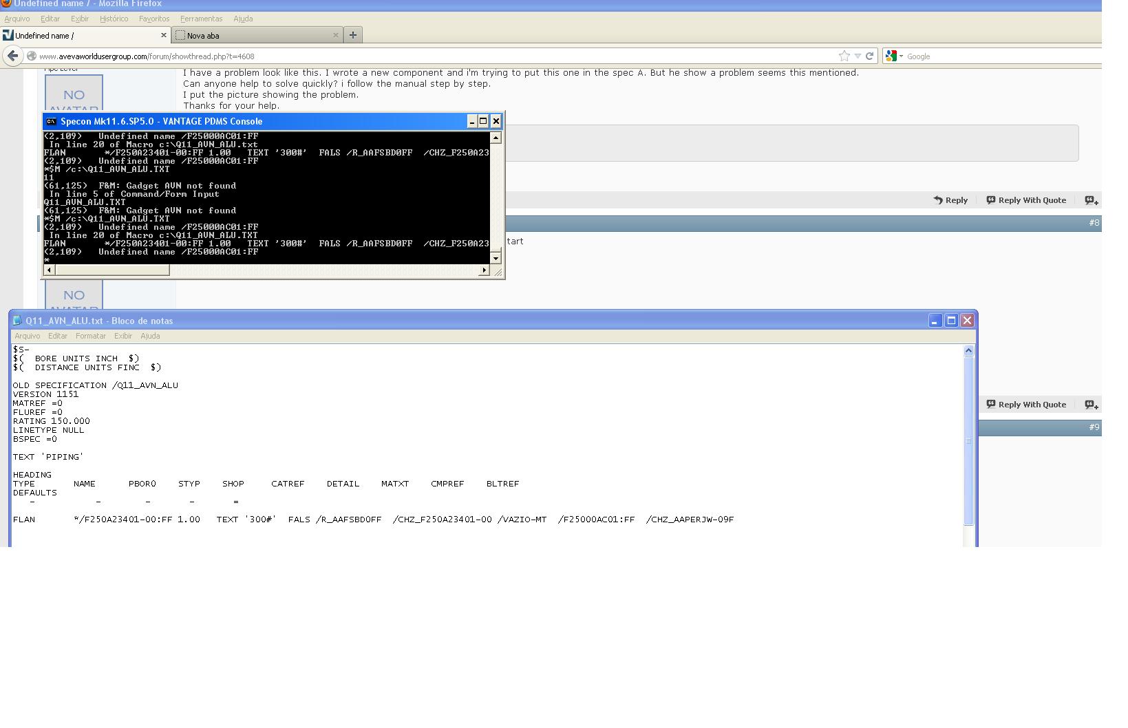

But how can i fix it? I put on specon and all time show me this me message ..."this spcom is rejected".
i reading a lot about this and i don't have any idea to solve.
I'm really Worry about it.

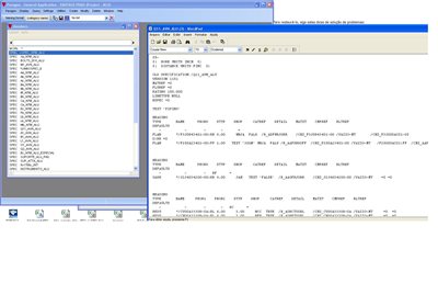

In PDMS 12 you can modify the SPEC easily in Graphis mode.
See for example: Catalogues and Specification user guides> cretae Specification.
It's explained how to Create/modify a SPEC. You can change easily te CATREF and other references
You do not have a CMPD in PROPCON for your CMPREF called /F25000AC01:FF
Since the :FF will be stripped off the SCOM name in reports maybe you should do the same with the CMPREF and use /F25000AC01
If that still does not exist you will need to create a CMPD in PROPCON first
