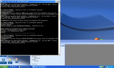

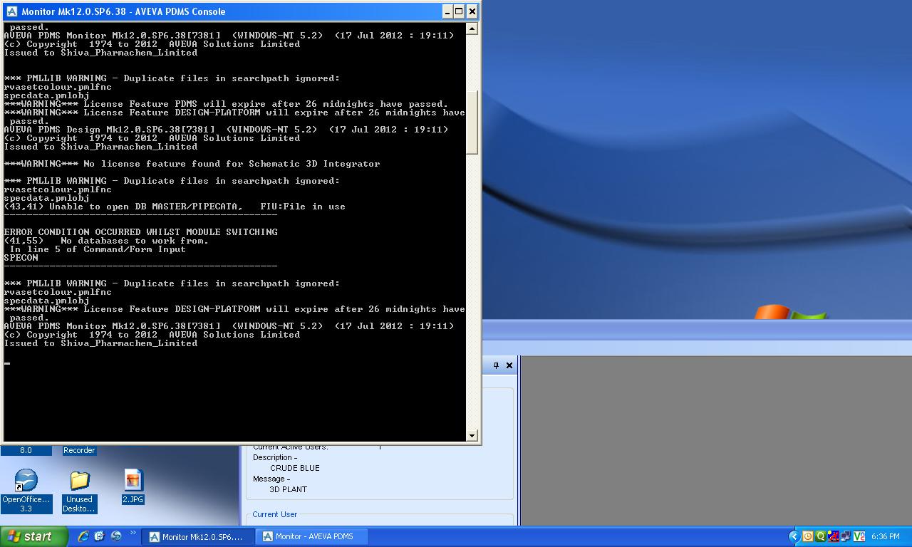

    Thanks Pitch,
    I have already expunged all users from current project. but still it is showing same error and throwing me in monitor.
  • Parag S Newe
    Parag S Newe over 12 years ago
    Pitch,
    I reset my server and now I can able to enter into Paragon. It is strange  but now problem is solved. but still I want to know what is exact problem and what is solution?
    Re-configuration is the solution for this kind of error?
  • john pitchers
    john pitchers over 12 years ago
    The message says file in use.
    Try making the DB MASTER/PIPECATA multiwrite
  • Thomas Back
    Thomas Back over 12 years ago
    If you close/kill a PDMS console application, it may continue to run in the background as a hidden process without window.
    That would still keep the database files open, even if you expunge users.
