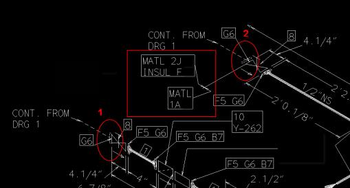

    at atta attribute spkbrk attribute made true or not?
  • Nguyen Hoang Kim Vu
    Nguyen Hoang Kim Vu over 11 years ago
    I split drawing at both positions by atta. I try set spkbrk attr to true but it don't show
  • Venkata Rao Peta
    Is data consistency is showing any errors.
    Try to remove the atta which is not showing and place again.May it may help
