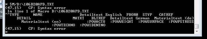

spec loading problem in Specon module
  • do you have HEADING before line with TYPE .... ?
  • at deva i checked the space , butt that is not the problem .
  • share the spec file not full atleast first line.
    so that we can find something
    HEADING
    Name                          Type  Detailtext 		PBOR0  STYP   CATREF              DETAIL                  MATXT   BLTREF  Detailtext 		Materialtext (de)       Materialtext (en)           :POWACTU  :POWWEIGHT  :POWSURFACE  :POWPSTRESS                    :POWTECHNO  :POWIDENTNO
    -                             -                         -      HP
    */APD_RAAQA00TTFPFP0000A0ZA0  ATTA  Comment             200mm  INFO   /APD_RAAQA00TTFPFP  /APD_RAAQA00TTFPFP0000  /A0ZA0          Kommentar          	nach Angabe             according to specification            0.000       0            0.0 0.0 0.0 0.0 0.0 0.0 0.0 0
  • Try this, only change spec name:
    $S-OLD SPECIFICATION /Name_Of_spec
    HEADING
    -                             -                         -      HP
    $S+
  • Browser ate TABs :))
    [COLOR=#333333]$S-
    [/COLOR][COLOR=#ff8c00]OLD SPECIFICATION /Name_Of_spec[/COLOR][COLOR=#333333][/COLOR]
    [COLOR=#800080]HEADING
    Name Type Detailtext PBOR0 STYP CATREF DETAIL MATXT BLTREF Detailtext Materialtext (de) Materialtext (en) :POWACTU :POWWEIGHT :POWSURFACE :POWPSTRESS :POWTECHNO :POWIDENTNO[/COLOR]
    [COLOR=#333333]- - - HP[/COLOR]
    [COLOR=#008000]*/APD_RAAQA00TTFPFP0000A0ZA0 ATTA Comment 200mm INFO /APD_RAAQA00TTFPFP /APD_RAAQA00TTFPFP0000 /A0ZA0 Kommentar nach Angabe according to specification 0.000 0 0.0 0.0 0.0 0.0 0.0 0.0 0.0 0[/COLOR]
    [COLOR=#333333]$S+[/COLOR]
