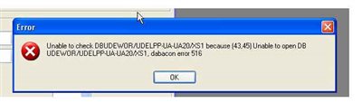

Dabacon error 516

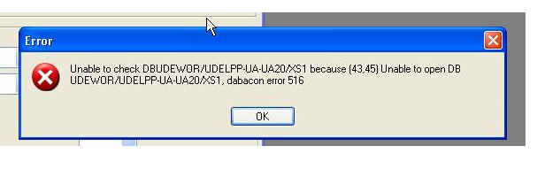

    May be something in this DB is claimed? Check it in claim list
  • avwf_rossy
    avwf_rossy over 18 years ago
    I've done all that sort of stuff
  • Yuri Krechko
    Yuri Krechko over 18 years ago
    may be global is not finished for this db? try to do in at night or lock project and purge all users
