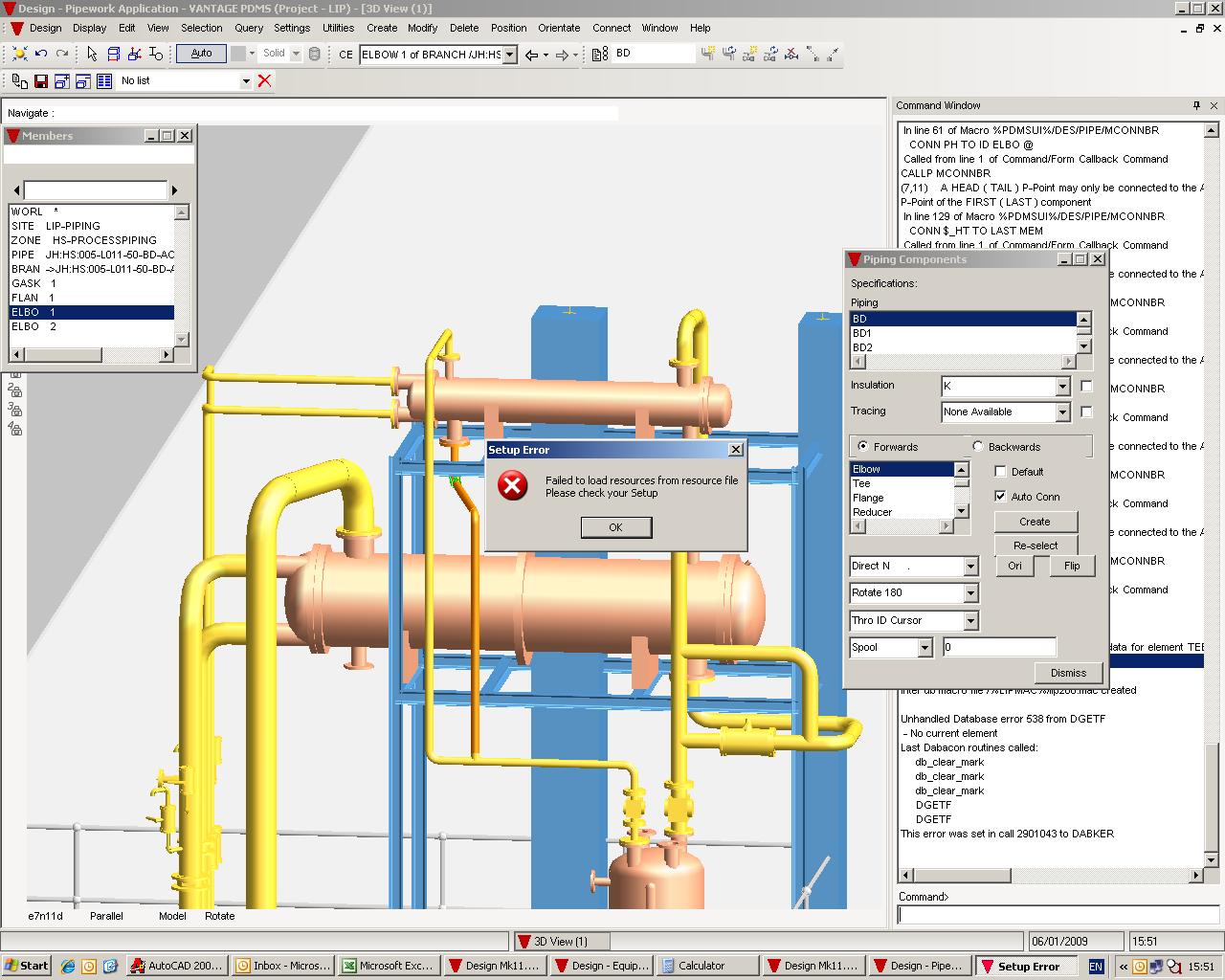

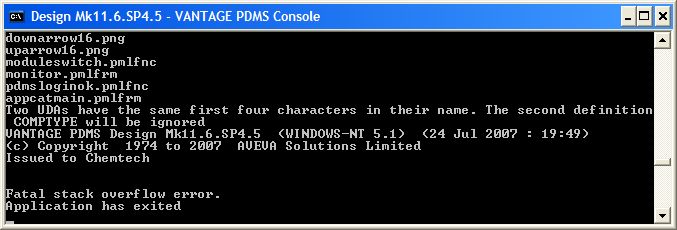

    When I have seen this error before it has related to a problem with self-referential PML objects. Check the PMLLIB path and verify that any extra PML files you have added are correct

    I got the same error message. But in my case it happens when I try to generate a Isometric System in Design. I really don't know how to figure out it. I also deleted the pml.index file, try again and still nothing.
    Does anyone have a more direct solution for this?

    If you look at the command line in the first post you can see that the error starts with:
    Error 538 No current error.
    Do you get the same error? Did you try and run the system iso in Isodraft?

    Can you run the iso's in standard mode (one by one not as a system)? Do the iso's run at all in Isodraft? Is the basicsys.met the standard aveva one and not one that has been adapted for the project?

    Yes I can. When I use any options file in standard mode, it works. But when I use the Isometric System/Trim Form and choose basicsys.met (Yes It's the standard aveva one) the error comes.
