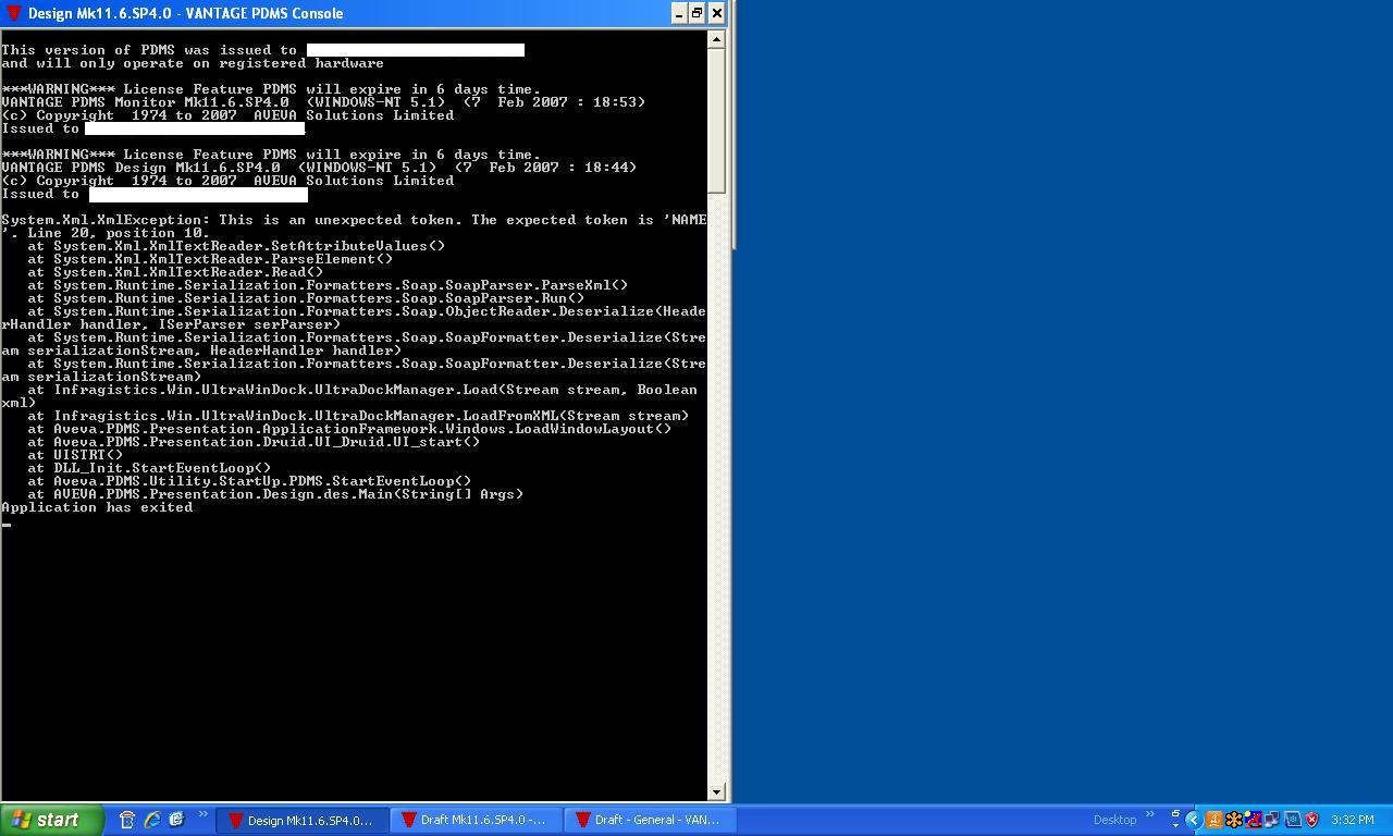

Error Reading Design Module

    try reinstalling pdms once again........after uninstalling

    Delete all BIN, XML and PMLDAT files in your %PDMSUSER% folder, and try to start again.

    Also clean up the pdmswk directory.

    Thankyou very much .....
    Its working now .
