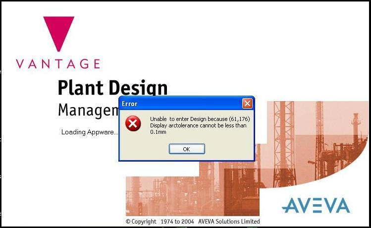

    can any one please help from this error (61,176) which is not entering me to design module
    giri

    Girish,
    Are you trying to enter PDMS loading from a binary?
    Try to enter loading from macro files. If it works, go to Settings > Graphics > Representation and set the arc tolerance for a value above 1.
    After that, save another Forms & Display in order to avoid future problems.
  • Orlando de Oliveira Amaral dos Santos
    Orlando de Oliveira Amaral dos Santos over 15 years ago
    Actually, it don´t need to be above 1, just above 0.1, like 0.2 and above is enough to avoid this error.
  • Thiago Sousa de Oliveira
    Thiago Sousa de Oliveira over 15 years ago
    Look you macro loginPDMSok, maybe there could exist some command that make this error happens.
    If you dont find any error, try put the arc tolerance by a command.....But I'm not remebering the correct command for this now....
    But the minimum is 0.1....
    BR
  • Cody Austin
    Cody Austin over 15 years ago
    Deleting the files in your PDMSUSER folder will solve this issue.
  • mEhul_patel
    mEhul_patel over 7 years ago
    I think error is te solve now, but i have one more solution . Go to your PDMS folder, pdmsuser then open des-rep.pmldat and change value of !!tmpgphrepopt.arctolerance=2
