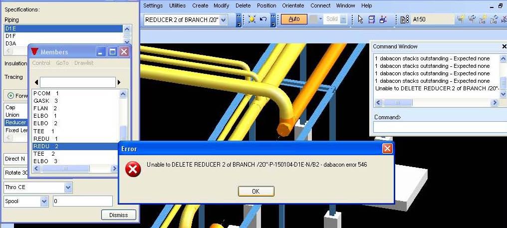

    546  'Attempt to remove element which is in more than one stack'
    My guess is that you should do a dice check with patch on on your DB. Look up dice check on the forum and the Admin manual.
    Hth,
  • R T
    R T over 15 years ago
    Perhaps the messages about "dabacon stacks outstanding" indicate that a GETWORK is needed?
  • PRASHANT PRAKASH UPARKAR
    PRASHANT PRAKASH UPARKAR over 15 years ago
    Try using this command MAP BUILD MDB
  • Joaquin Josaphat Morales Garcia
    Joaquin Josaphat Morales Garcia over 9 years ago
    This fix works
    [URL="http://52.178.132.139/archive/index.php/t-3402.html"]
    52.178.132.139/.../URL]
    :encouragement:
    An update, when a UDA with pseudoattribute fails to calc a value, rise this error, to remove element, locate that UDA and set correct value. Check why UDA triggers this error and fix it or remove.
