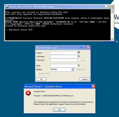

    Is this a Global Project? If yes have you installed Global? Also check the OS (Service Pack) Compatibility on Aveva website.

    It's not a global project friends............ Only the project setup is recieved not the evars.bat......I think no one share their batch file( evars.bat)

    [QUOTE=nareshtarani;45224]Hi friends, For the first time we are using PDMS12.0.SP5 in our company, We got the project setup from one of our client, When we are trying to open the project by using login form as shown in jpg , we are getting the DATABASE ERROR 523 as shown in the jpg .
    Info :- I mapped the project into one drive as usual i followed the procedure to set the project
    set TRA000=J:\TRA\TRA000
    set TRAISO=J:\TRA\TRAISO
    set TRAMAC=J:\TRA\TRAMAC
    set TRAPIC=J:\TRA\TRAPIC
    set TRAADM=J:\TRA\TRAADM
    set TRADFTS=J:\TRA\TRADFTS
    set TRADIA=J:\TRA\TRADIA
    set TRASTE=J:\TRA\TRASTE
    set TRATPL=J:\TRA\TRATPL
    NOTE:- Without the above project setting, I can able to enter inside Sample project but by setting above When i try to open project through PDMS Login form , I am getting the below error as show in jpg (Image).
    Help me regarding this Friends to resolve this,
    Thanks & Regards,
    Naresh Tarani
    try set this in your evars:
    I have encountered error before when i included the ff:
    but i forgot if this is the same error that you encounter.

    It is module definitions for AVEVA Marine giving the error messages. The modules are defined in modmac.mac. Modules 90 -> 93 are for marine, and gives the error message if the file is missing in PDMSEXE.

    TBack, I want to create a New Project for Plant design through AVEVA PDMS 12.0.SP5 ...............Is there any problem in my syntax above...?

    malonie , I tryed the following too.....
    But Didn't succeed ..............
    These four are the ones needed to run PDMS. See also DWN06 his post.

    ya....ofcourse that's right, I agree with you friend........but my problem is not about evars.bat setting it's all about I AM UNABLE TO CREATE NEW PROJECT  ,.......Did you noticed or read what is the error that is coming while i am creating a new project  (I posted above in the previous post).........
    I tryed with setting which has been suggested by DWN06 .......
