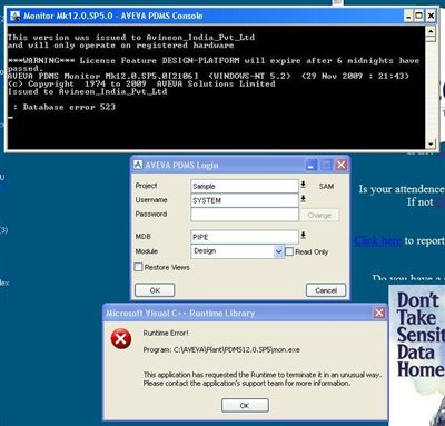

    Check youe EVARS.bat. Look at your setting for project SAM and do the same for TRA project.

    ykr...........I think the above syntax which i have shown in the above post is 100% correct ,  Is there any wrong in that...? Same thing i have set in my evars.bat , My project is in server hence i mapped it into 'J' Drive...........

    Even though i tryed with re-installation, I am not suceeded Can anyone help me in this regard...?

    Let me ask you something, are you trying to create a new project or TRA is a existing project?

    TRA is an existed project from my client and TST is a new Project which i am going to create (Just for testing whether project can be creatable or not)  Since it has shown errors i conformed that something is wrong with PDMS Instllation,,............

    If TRA is an existing project, and if it is a PDMS 11.6 version, you must convert it before you can open it with PDMS 12.

    It's not created using 11.6 version , The project is created using PDMS12.0.SP5 only,.......

    If it is created using 11.6 version, I know that i have to upgrade it and i know the procedure too..........But the thing is It's created in PDMS12.0.SP5  version only and it is by my client and moreover the project is working good at his place and problem which i have shown in my first post is @ my place (Loaction) only.........

    What exactly do you mean "We got the project setup from the client?"  If that includes the EVARS.bat file then you need to change it.  Copy the evarsSample.bat setup and add your folders to the end.
    I would also switch to UNC pathing and only set the 4 basic folder locations  000 and ISO and MAC and PIC to see if it works.  Work your other paths in one at a time.
