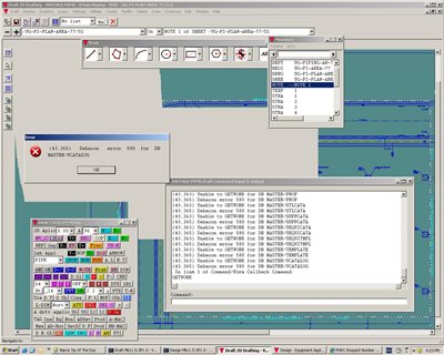

one of our users (PDMS11.5) always refer by attached error when working in draft module any body knows the reason to help me???
also i should mention that this PDMS login(user/pass/mdb) works fine in my computer when i tested !!
if you have the same evars for all your team,may be that the MAS project is in a other path for him
exemple:project master SAM IMP could be place in c/aveva/plant/pdms12.sp5/project for one user and the others ,these project are in c/aveva/plant/pdms12.sp6/project
yes i did DICE and no structural errors was found !! when user tries to chane some tags and annotations in draft module or else.. this always happens.but this actions creates no error on my computer.
