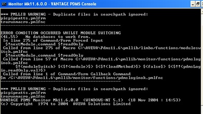

Error code (41,55)
Chaiwat a
Chaiwat a over 12 years ago

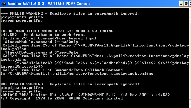

    Error may be caused if u are trying to open PDMS when project backup is copying or u dont have any Database in your MDB for the module you are entering.

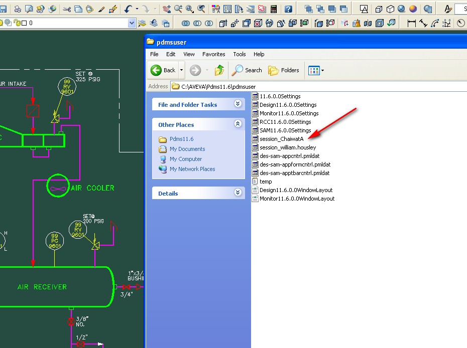

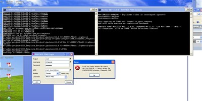

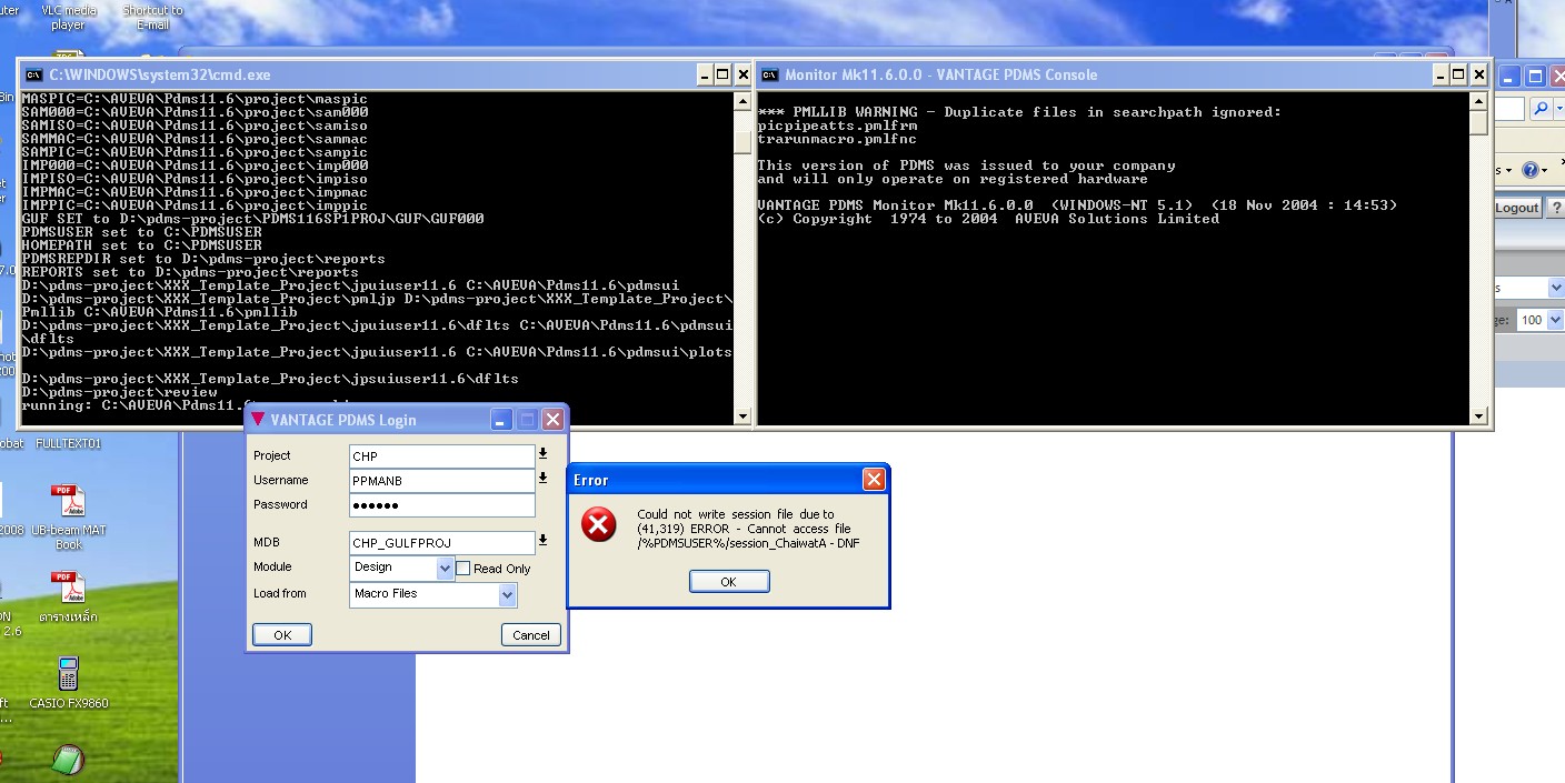

    please see attached file picture.
  • Venkata Rao Peta
    Venkata Rao Peta over 12 years ago
    check access to your pdmsuser folder...
