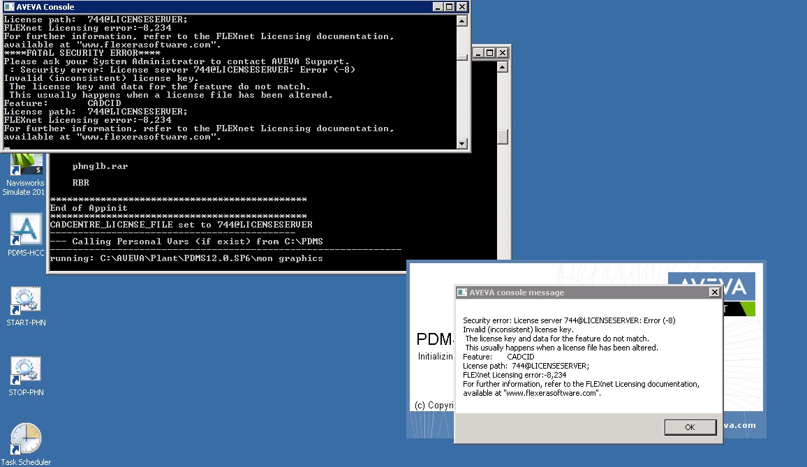

Error Codes Error WITH LICENSE

Error WITH LICENSE

    restart the license server may solve the problem..

    Hi Deva,I'm going to restart it as soon as no one else is working in the model.
    My question is, only in the server this is happening, on the other computers that acess the model, this haven't havepend.
    SHouldn't all of the computers present the same problem?!

    pla, renew  aveva license  file

    Probably this problem was caused by you are accessing the server remotely, because I had the same problem and I was trying to run the PDMS remotely, after that the access was done localy this message didn't appear.

    Nice tip rcerqueira, that was just the problem!
