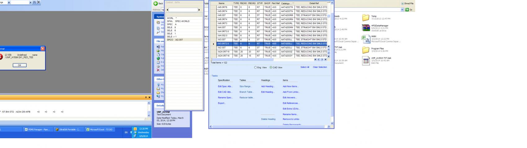

I was trying to spool a pipe when this erro appear.But a look at this reference and i didn't find it in the pipe.
Why this happy? Why i don't find this reference ?
Thanks.
That is the point of the message, it does not exist, presumably because it has been deleted. However something in your pipe was once connected to it and the connection has not been re-set.
Check your HREFs TREFs on branches and CREFs on TEES OLETS etc.
