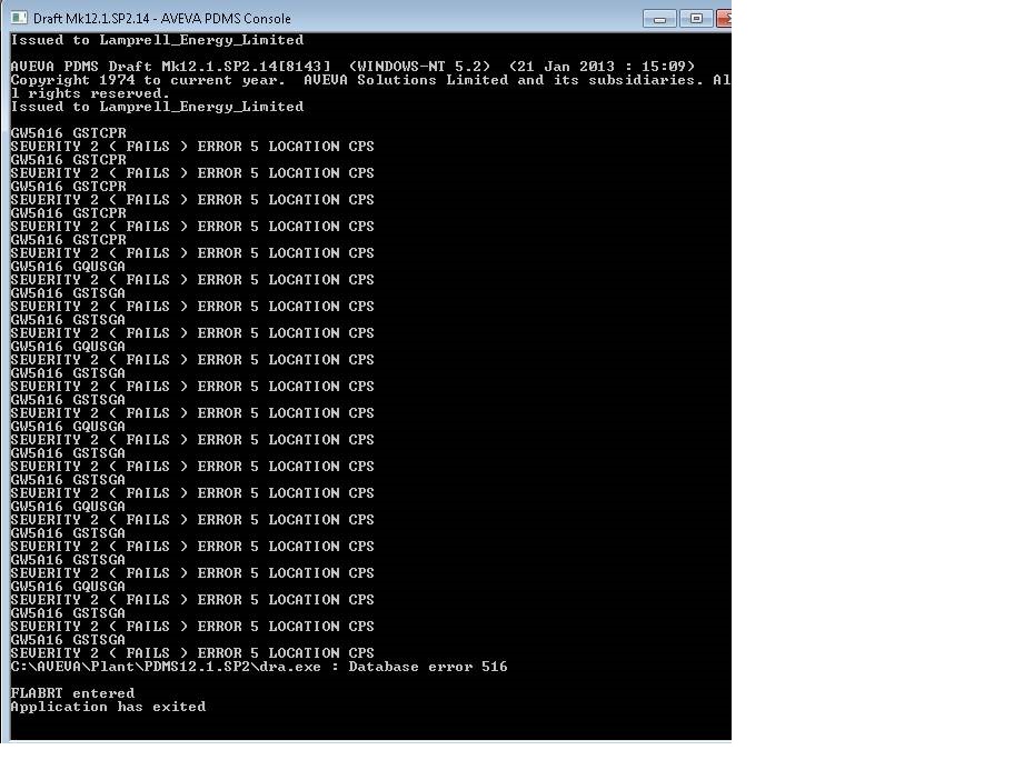

    I am getting Dabacon Error 516 for DB PIPE/444-DES-MECH-01 while saving the Drawing in Draft
    using Aveva plant 12.1.sp2.4
    AS PER DATABASE CODE WHAT I UNDERSTAND
    ERROR 516  'Session page not found'
    can expert confirm its appearing due to network failure issue ?

    Did you do a DICE report to check the DB?

    Do a dice check of the db with patch on if  that  does  help not go for reconfiguration with sameref. Be  careful and make a  back up  copy of the DB.
