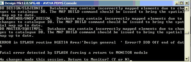

This is what we have observed during our clash check. if the database are not properly map built it may create fatal spatial map errors and expunge user during the process. This was the reason we prompt the user to map spatial before starting the clash application. Auto $!clashing is just a command like AUTO CE which bring the current element in the view limits in the view.
