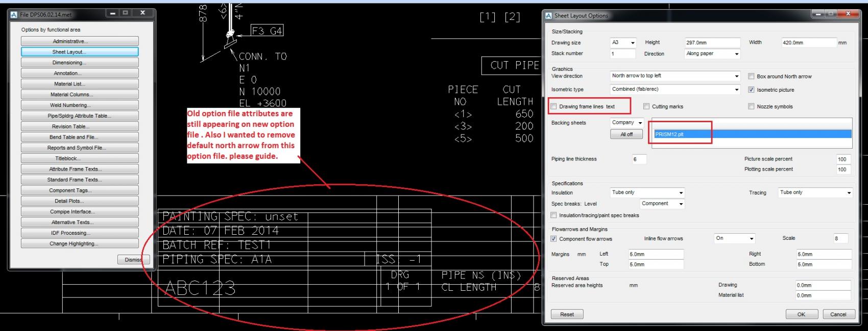

Thanks RUAV,
I have removed all old option file Atext as per your advise & I also referred the manual for the same, but I am unable to remove pipe name, I have updated " TextPosition NAME X 0mm Y 0mm CharHeight 2mm" in option file but still pipe name showing in isometrics. Also kindly guide to remove old north direction symbol from isosheet.
Hi, I have removed the default north arrow symbol in option file using, modify/option file/standard frame text & given x & y positions 0,0 to north arrow.
so please guide me for removal of atext of deault pipe name from option file.
