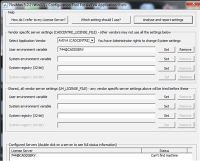

FlexMan Error -96
Usman Shehu Isa
over 11 years ago
Admin
over 11 years ago
check hostname. is it CADDSERV?
Usman Shehu Isa
over 11 years ago
Usman Shehu Isa
over 11 years ago
Yes it's CADDSERV.
Corrado Galluzzi
over 11 years ago
Switch off your anti-virus or your firewall.
Or open the specific port (744)
Usman Shehu Isa
over 10 years ago
Thanks Corrado, your suggestion worked.:encouragement:
