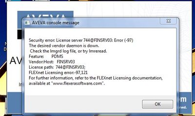

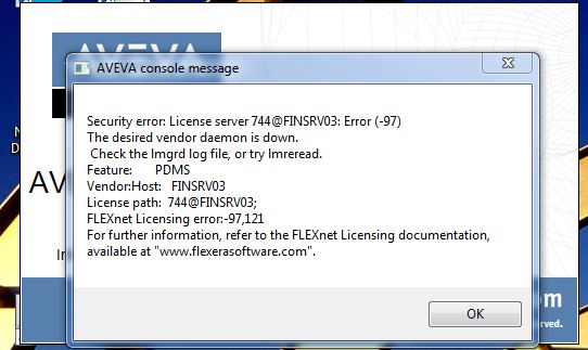

Flexman -97 121 Error
Rahul Mali
Rahul Mali over 9 years ago
  • Rahul Mali
  • Pedro Valadares
    Pedro Valadares over 9 years ago
    It seems the license server cannot be reached. Launch cmd.exe and ping FINSRV03.
    A possible solution might be to restart the license machine.
  • Shadab Hussain
    Shadab Hussain over 9 years ago
    This error because u dont get Network licence to pdms
  • Venkata Rao Peta
    Venkata Rao Peta over 9 years ago
    check out license server, whether it is shutdown??
    go for Aveva License System instead of Flexman, it is preferable now.
