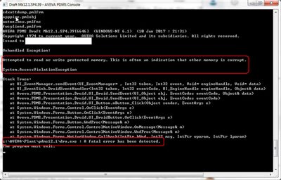

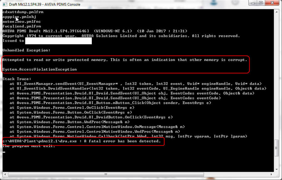

1. please check if the network is not getting disconnected when you are trying to update the drawing.
2. Dice check the drawing DB and confirm the database is not corrupted
hi atish
in my model, many *.stp files imported and steel model from Tekla.
if i did not use "hatching rules" in draft drawing , all drawing can be updated
if i use "hatching rules" , fatal error appeared..
