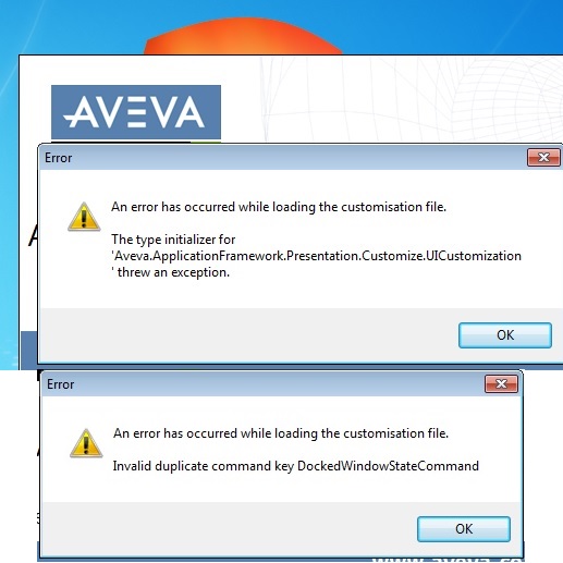

"Threw and exception" error while loading Draft

[COLOR=#333333]Try deleting/emptying C:\Users\[/COLOR]
username\AppData\Local\Aveva\PDMS
Usman Shehu Isa
over 5 years ago
Hi me_hungry....the designer's system is a thin client, it has no C:\Users\username folder....what it does have is a
C:\Users\public folder....
I sure a reinstallation of PDMS will solve it.
