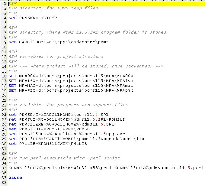

    Hi
    I want to upgrade my project from 11.2 to 11.5 but I couldnt find the " pdmsupg_to_11.5.perl" & " pdmsupg_to_11.5.mac" in pdms11.5 upgrade folder is there anyone have these files?
    Thanks

    [QUOTE=brm;34845]Hi
    Thanks
    Try reinstalling PDMS, they should be there.
