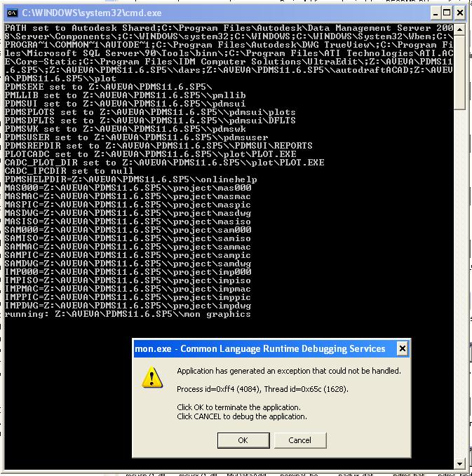

  • kalpak vartak
    kalpak vartak over 15 years ago
  • Thomas Back
    Thomas Back over 15 years ago
    You must allow .NET application to be run from the server.
