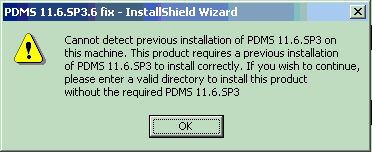

Cannot Install sp3.6 directly from sp2.2
  • Usually a fix release (with a .digit on the end) is not a complete release, and just replaces a few bits of the parent release. You will need to install 11.6.SP3 first, and I don't think the full Service packs are available for download, so you will need to contact AVEVA and get a CD sent to you.
    Tim
  • Thanks Tim...you were right....i had to request a CD fro Aveva which i got it today.....and after sp3 installation i was able to ru sp3.6...
    just wanna make sure one thing..when i ran the sp3 installation, it didnot automatically detect my old sp2.2. installation...therfore i simply selected the same folder where my sp2.2 version was installed when prompted for the installation folder....and installtion was completed without any erors......and checked with help about, and its now showing sp3.6you reckon is dat ok ?
  • I don't know I am afraid. I usually install them in parallel (different folders), but that is because I want to test interfaces against several different service packs. sp2 and sp3 probably have very similar lists of files, so I would expect that it would not cause problems
    Tim
