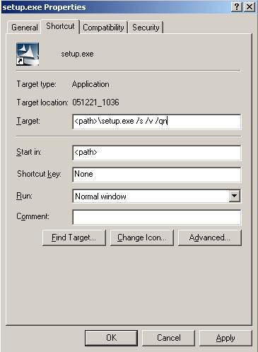

• [QUOTE=osnabrr]I tried the earlier given setup options in a DOS box, but every time PDMS comes with an userinterface and questions to press a button.
    I tried it on the 11.6SP3.6 service pack
    Initiating setup.exe from a "DOS box" usually does not pass the parameters to the Microsoft Installer correctly. If you have to start it this way, you can try typing (do not type the single quotes) 'start ""
